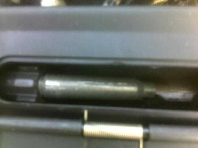

I just got my AR-15 back and it had been sitting for a few months so I wanted to clean and lube it. I did a basic feild strip cleaned it up and put it back together. Took it outside and on the first shot the extractor held on to the empty case and jammed up the fresh round that was trying to come up. I got the fresh round out by dropping the magbut I cannot get the empty out and I cannot open the upper to pull out the firing assembly ..what did I do and how do I fix this..like I said Im new to ar's and I've never had this issue before. heres a pic sorry its a crappy cell phn pic.

take something that will hook into the neck of the empty casing and pull it out that way (That is the natural way the shell should eject). Sounds like your bolt extractor plunger and spring may be clogged up or worn out. May need to either replace the bolt extractor plunger and spring or I would trying cleaning and lubing that area before replacing....the tension on the bolt extractor plunger should be such that you cannot press it in easily with your finger....

Have you tried grabbing the empty shell and pulling it free of the extractor.
When you cleaned this gun did you take the bolt/extractor apart?
#5 ·
I quess I'm puzzled why you can't take the upper apart? Bolt locked back? Ride it forward, rechambering the empty case then take it apart like normal. Soak you bolt in some breakfree or similar. Try it again

finally got the bolt to go forward all the way and dissasembled...:oops: had the bolt upside down..sorry.
thank you for the info, I ran the rest of the mag through with no more issues.

1. I took the cam pin out,
2 took out the firing pin,
3 pulled that stubby bolt thing (lol I know) out of the top
4 rotated the bolt till the other side of the hole was visible from the top
5 put the small bolt back in
6 put the firing pin back in then the cam pin and reassembled...
shoots and extracts fine now ..I dont know..Again I am a newb when It comes to rifles especially the AR-15
