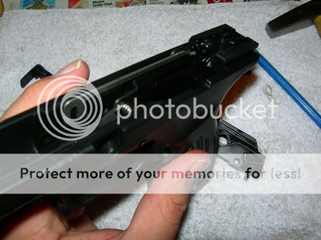

The 1st issue I ran into is that the disassembly lever no longer runs through the entire frame. How the heck am I going to push the disassembly lever out?
Here's how:
Turn the disassembly lever about 45 degrees to the LEFT or pointing at about 10 o'clock. You will know you are at the correct angle just after you hear a "click". Gently pull the disassembly lever out a bit. It will come free and then you simply need to twist it as you navigate it past the slide stop lever spring and pull it clear of the frame.

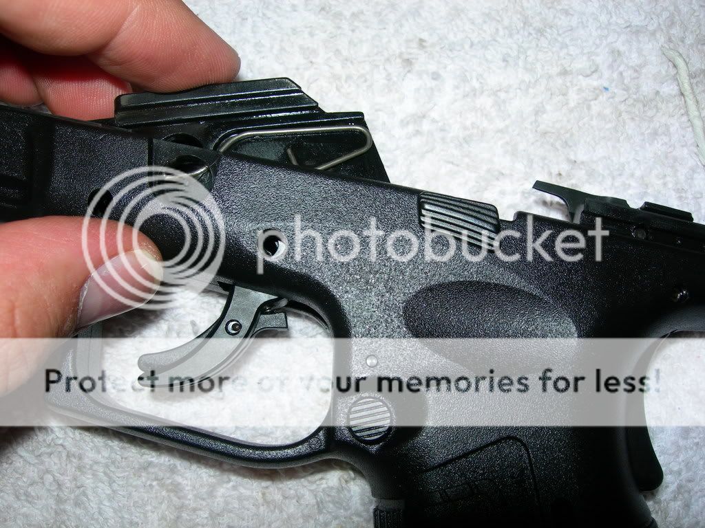

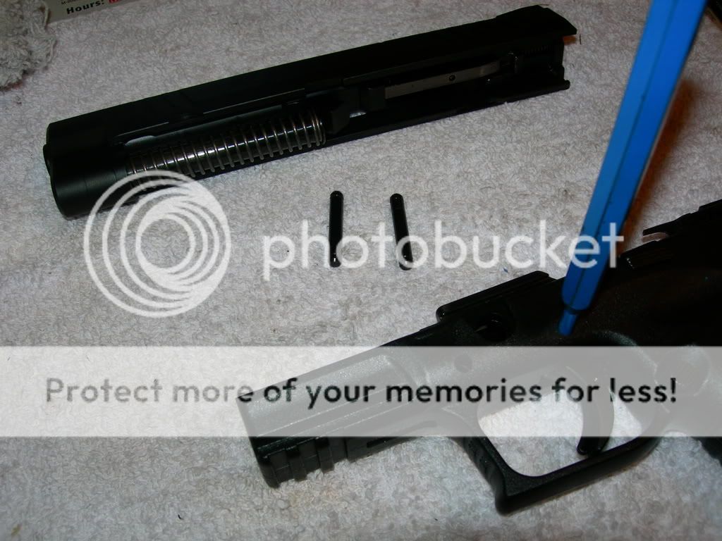

Next, remove the locking block. Using the 3/16 punch first remove the two pins holding in the locking block.
Then gently lift the locking block up out of the frame.

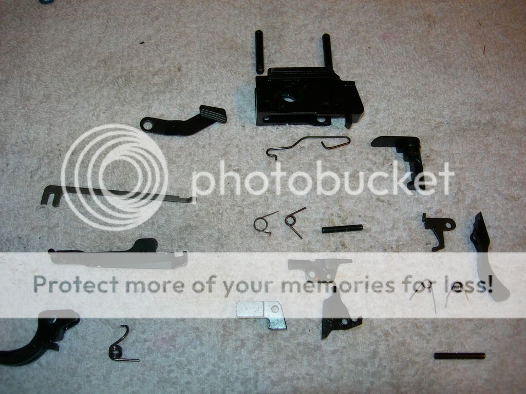

It should now be easy to remove the slide stop, Trigger assembly and... look at that another new piece! (I do not know the official name of this piece, but as far as I can tell, it acts as a safety so that when you field strip the firearm you no longer need to pull the trigger to free the slide.)
Here's what you should have so far:

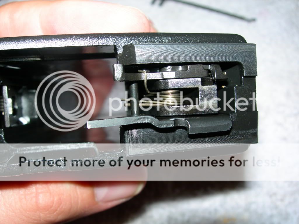

Now, there are some new components in the rear frame as well. I removed these with the intention of polishing the sear components to hopefully slightly lighten/smooth the trigger pull, as I did this my XD .45. IT APPEARS TO ME THAT THE SEAR COMPONENTS HAVE A VERY DURABLE AND HIGHER QUALITY FINISH THAN THE REGULAR XD. I began using mothers polish on a few of the pieces and... they don't seem polishable, unless you feel like removing the finish that is on them, and I don't.
Now, you have your reasons for wanting to disassemble things, but I highly recommend staying out of here. Every thing comes apart fine, but getting everything back together isn't very much fun.
Please take notice at this time that there is a new sear spring(s) now. Pay close attention to how the 2 sear springs are wrapped around each other and how the new spring wraps up and over the safety lever.

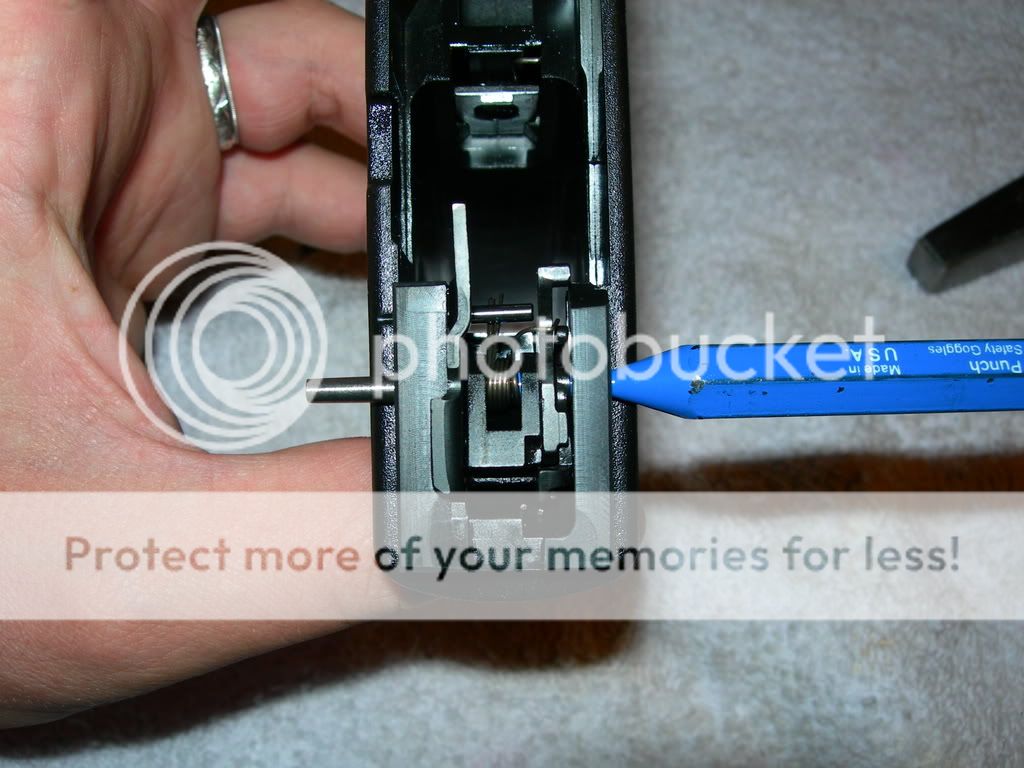

Using a small punch or screwdriver move the smaller, front sear pin out of the way. It's not necessary to take this pin clear out of the frame, just give your self room to work.

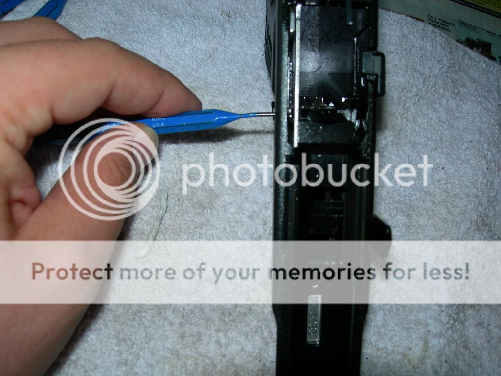

Now use the 1/8 punch to remove the sear pin CAREFULLY
I try to get the punch clear through.

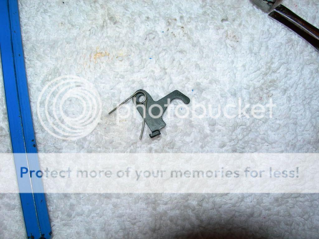

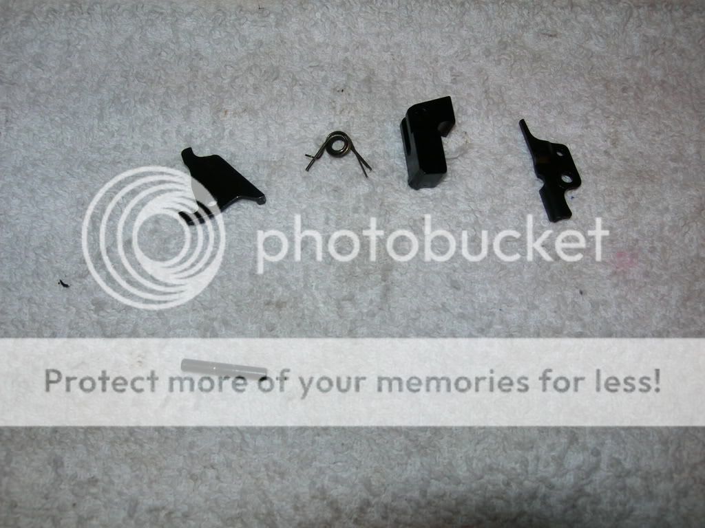

Carefully pull the punch out an be sure to watch where the sear springs drop. Remove the sear assembly and you should have a pile of parts like this:
safety lever, sear spring, sear and ejector.

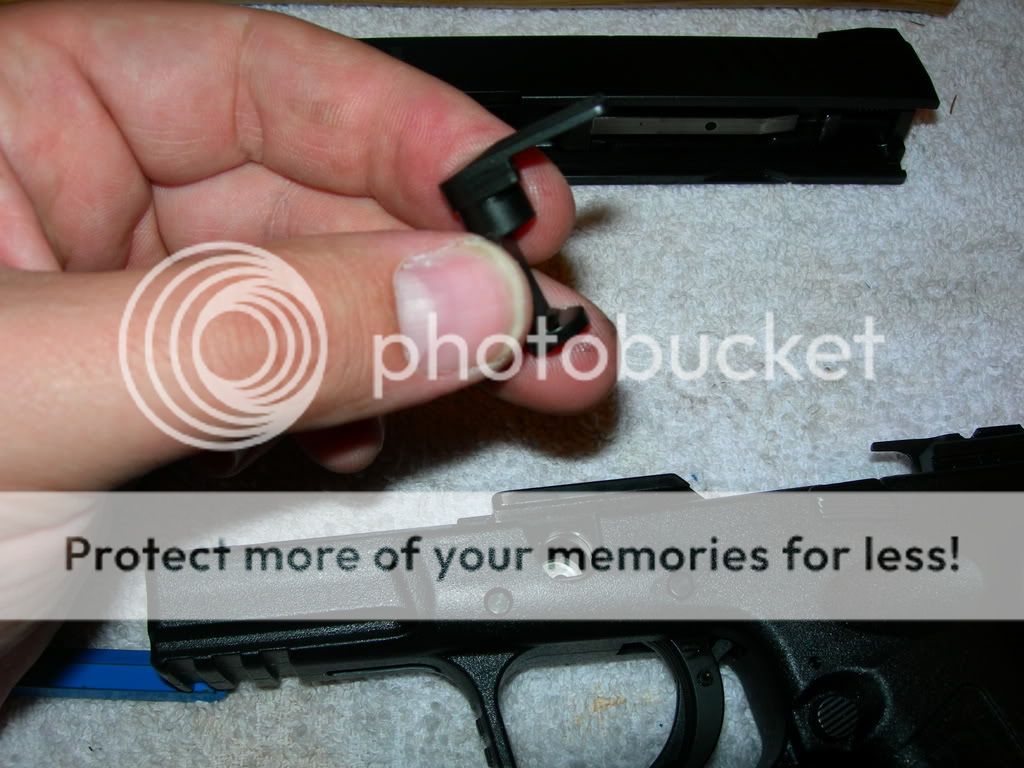

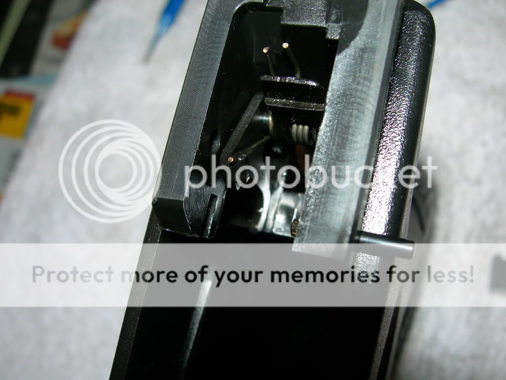

Alright, all we have left is the grip safety, oh, and another new part. Again, I do not know the proper anatomical term for this piece but I am thinking that it is part of the safety system that allows you to field strip without pulling the trigger.
At this point I HIGHLY advise you to stop here. Reassembling the grip safety with this new part and its spring was very difficult.
The new bits
Grip safety assembly from 2 angles

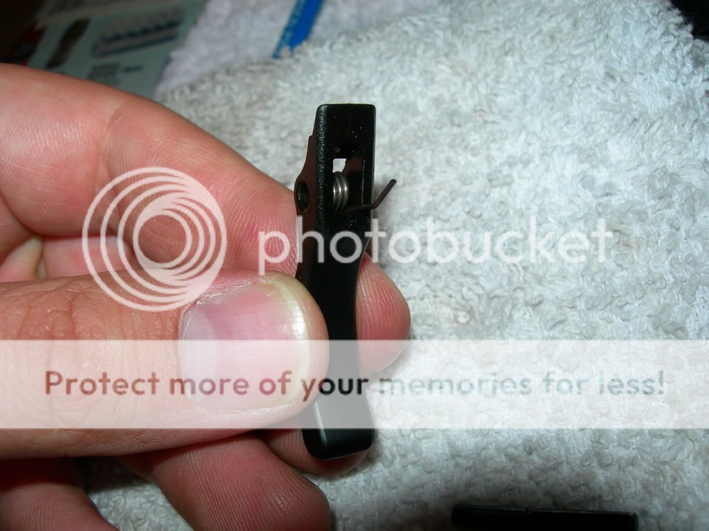

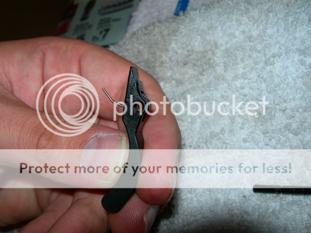

If you choose to remove these use the 1/8 punch again. THE GRIP SAFETY SPRING IS UNDER TENSION AND CAN POP OUT AND FLY ACROSS THE ROOM!!! Remove this carefully.
Here are a few photos of how the spring fits into the grip safety:
Also notice that the pin that holds the grip safety in place has a groove in it and this grove is off center. This must be reinstalled properly or your grip safety will not work.
If the front of the slide is facing you as you insert this pin the grove needs to be on the right side of the frame.
