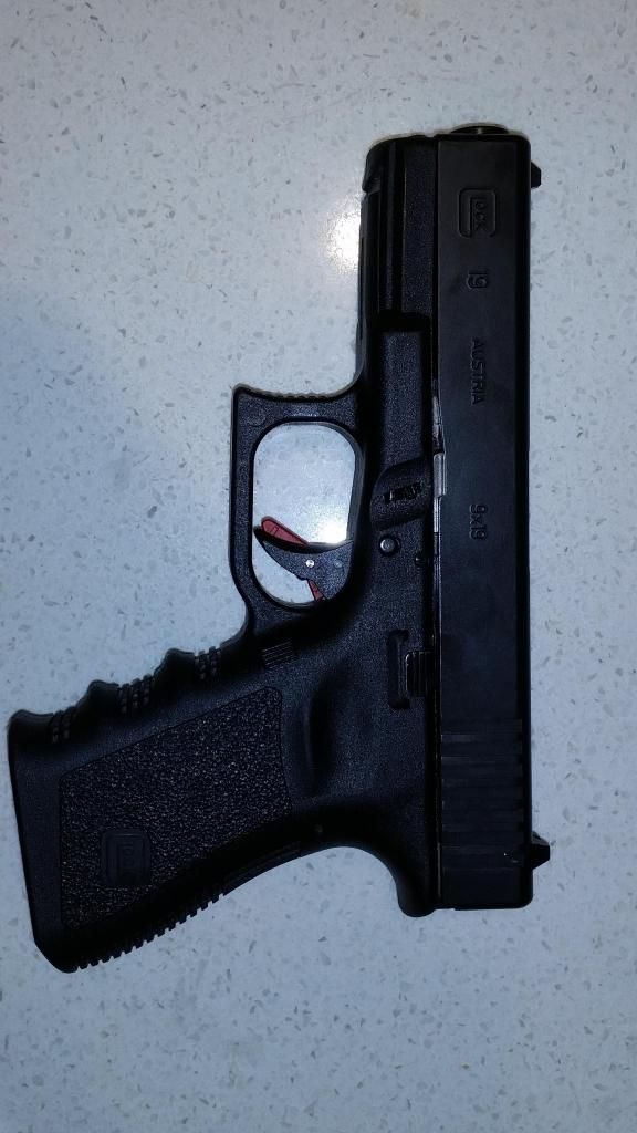

Here's my experience so far with the OC Custom Trigger: I have just finished install and have yet to fire any shots.
Customer Service: I ordered this trigger online on 1/5 and received on 1/16. OC did notify me that it was on a delay and would not compromise quality for fast shipping. I received a notice on 1/12 it had shipped and arrived before I had tracking info.
Parts: OC uses oem glock parts and modifies it with their pre travel adjustment screw. I ordered the smooth face trigger with the red safety tab (they offer many colors). The oem parts came pre polished to a mirror finish, just as any glock trigger job would. I would say the install went very easily, even for someone who's is not familiar with glock internals. However there were no instructions on dropping the trigger assembly and bar in. The kit only includes the trigger group, a small Allen wrench and instructions on adjusting the pretravel screw.
Results: This trigger dropped the pretravel to approximately 1/16th inch or slightly more. It can be fine tuned with the pretravel screw but I could not achieve better results after a certain point. The over travel is nearly unnoticeable with this setup as well.
Overall I feel this is an excellent upgrade for $40. It does not include any reduction springs but all pre and over travel issues are addressed with this upgrade and the polish job helps as well. I will post results of the trigger upgrade after my next range session.

Took the 19 out to the range yesterday. The trigger is significantly easier to fire faster. It helped in reducing my group size while firing at a semi fast rate. Overall, I put 95/100 in the 9 and 10 rings. No pics guys sorry. Follow up shots are much easier and reduced movement helped stay on target much easier.
Honestly this upgrade increased my shooting more than expected as I have never used and aftermarket trigger in a pistol.
