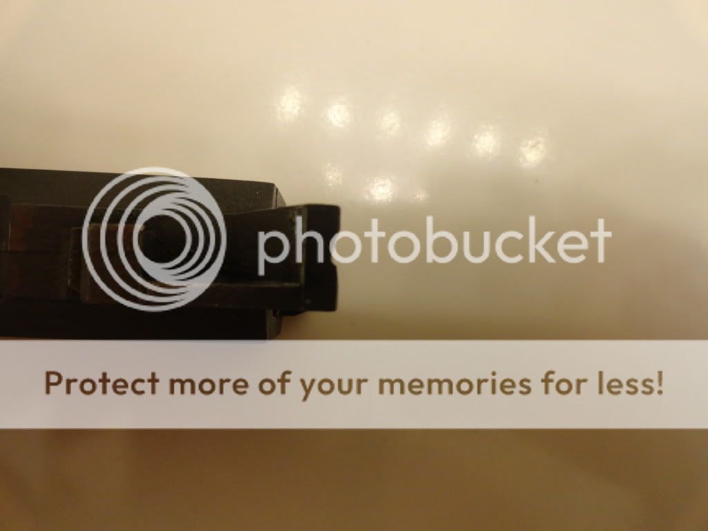

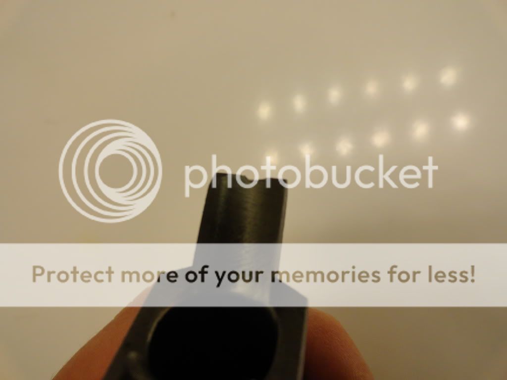

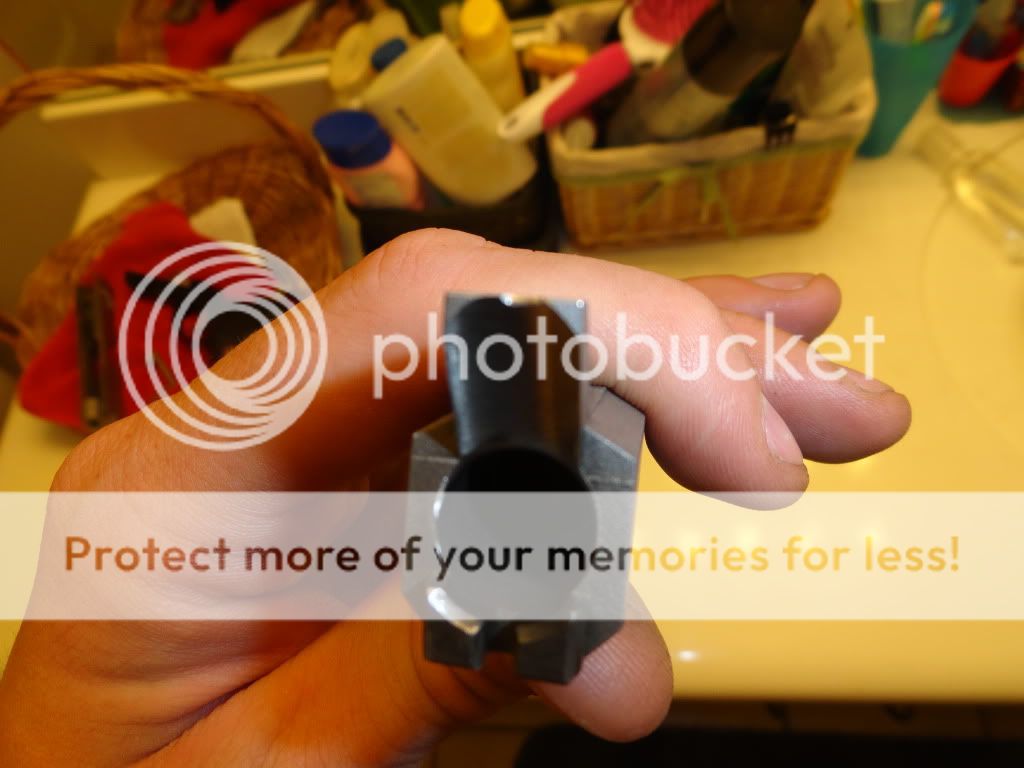

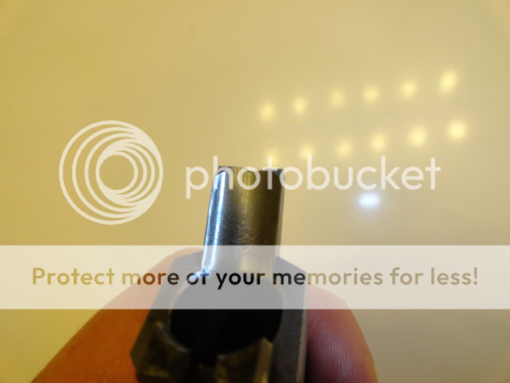

I took my Ruger P345 to the range yesterday, and when I went to clean it I noticed something that wasn't there before. I didn't have any problems out at the range, and shot 150 rounds no problem. When I took the gun apart I noticed a "chip" on the bottom of the feed ramp. I know for certain this was never there before. I bought the gun in February of 2009, so does anyone know if Ruger will repair this under warranty? I've already got an email off to them, and I'm just waiting for a response. I'm hoping someone on here can give me some good news before Ruger responds.

I got an email back from Ruger. They want me to send photos along with the serial number of my gun, so they can determine if it was something I caused, or a defect. If it's a defect they will repair the gun free of charge. If not, then it's $30 for the repair and $35 shipping. I'll keep you guys posted.
To be honest, i'm going to be real upset if I have to spend $65 on something I know I did not cause...

If Ruger won't address it, it looks like something you could try to blend out to a radius pretty easily with a dremel or a fine, round file and then polish.

All respect to Dan, but I wouldn't try this.
A chip on the feedramp occurs if there's a fault in the forging of the barrel there - the ramp is a high wear spot because the nose of the bullet scrapes the feedramp. For it to fracture under what amounts to minimal load, there may be a fault in the steel that comprises the entire barrel; that problem may not be localized to just the ramp. This may mean that your barrel isn't safe to fire. If I were Ruger, I'd just replace it rather than risk a +P load blowing up your gun and possibly injuring the shooter.
If you work on it yourself and it blows up, then Ruger would not be responsible for anything that happens to it. My opinion is that you should do exactly as Ruger says, including pay for any repair if they decline to fix it (this would surprise me no end if they declined to foot the bill).
Please don't take chances with your safety.
