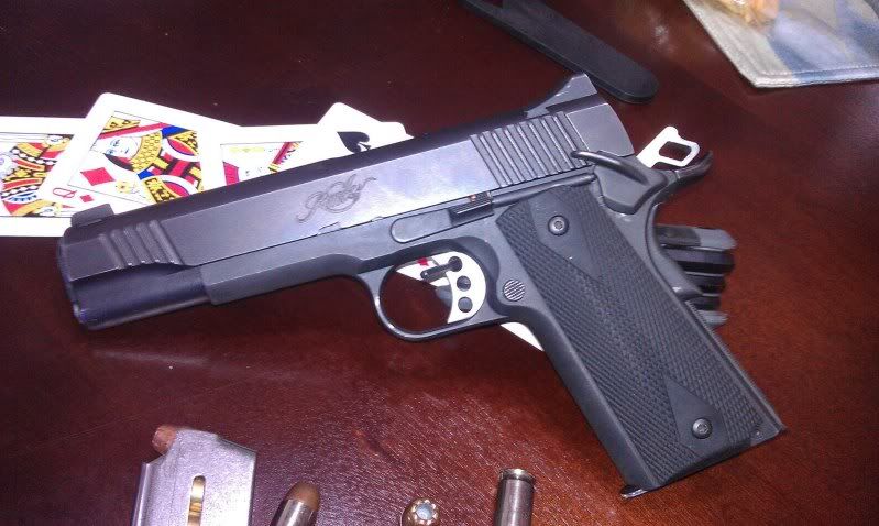

The Finished Product - Exactly what I wanted, a slightly retrofit carry 1911 with a fine look and a near perfect trigger pull.

I apologize for the photo quality. It came off a cell phone.
