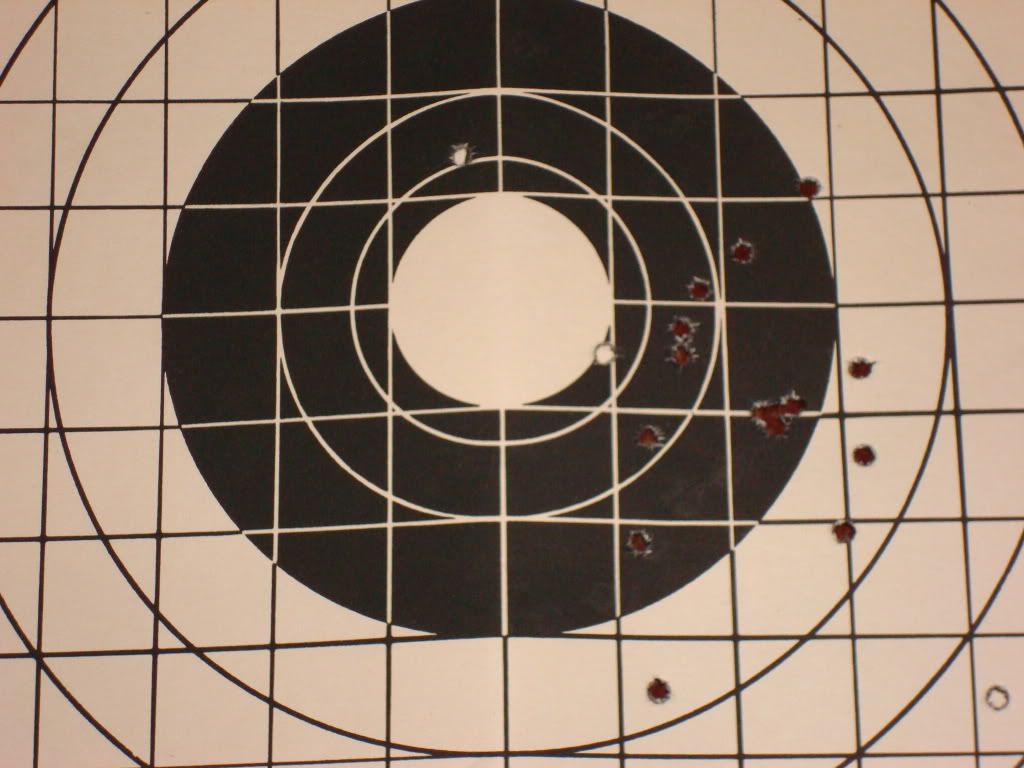

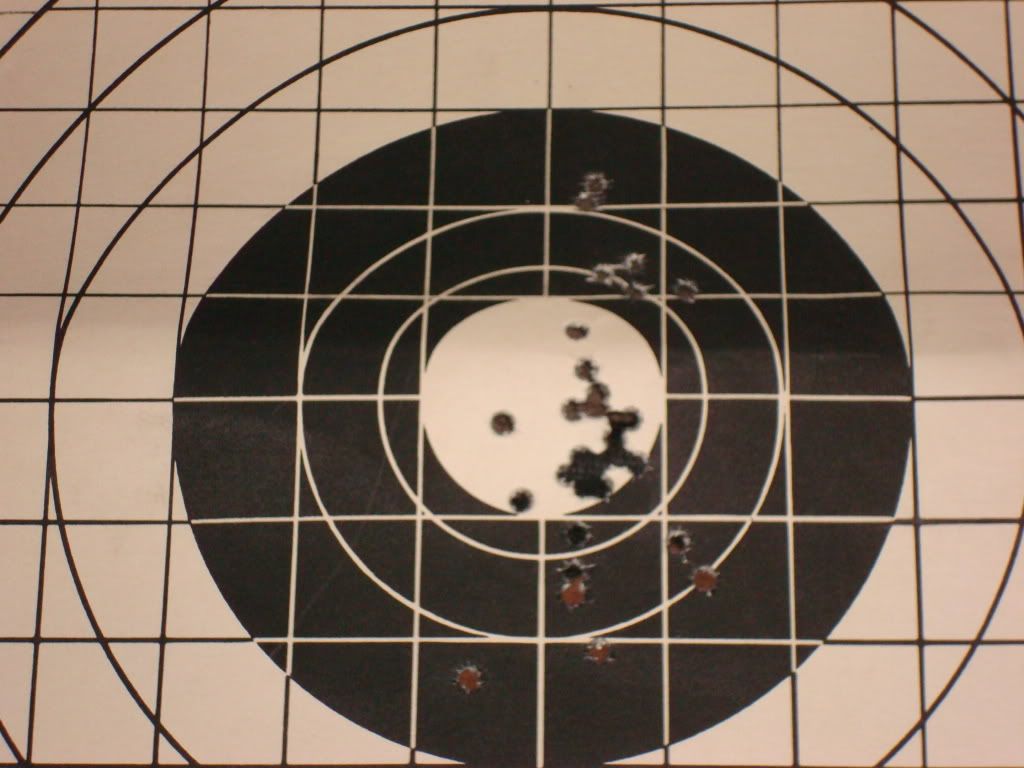

So I just got back a little bit ago from the range. Had a great time and the stag ran like a top. No problems at all. Probably went through about 80 rounds or so and was there about 2 hours. I fed it some from Prvi 5.56 M193, Black Hills and PMC .223 and the Stag loved it all. To me the recoil was lighter on the .223 compared to 5.56, I didn't think I would be able to tell the difference. I do have a question..is it normal to have a small crease or dent on the side of every spent casing? This is just something I noticed. Oh and also is some smoke coming out around the chamber area normal after every shot? I attached a few pics as I progressed. I was pretty pleased as I have never shot a rifle before and also I had to shoot left handed which I have never done either. I forgot to add these are all at 25 yards out.

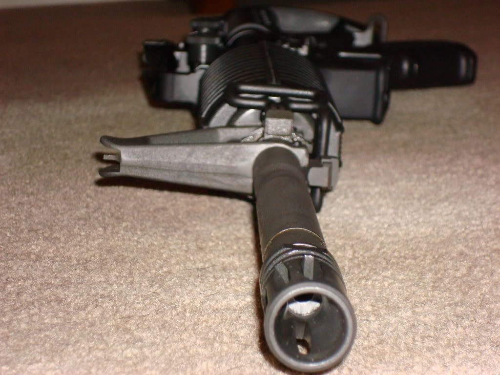

and one of the rifle

Your targets look OK, you just need more practice. We all do.
As for the Smoke you were seeing, it was more than likely just some oil/preservative being cooked off the gas tube and or bolt. Nothing to worry about. Make sure to give it a good cleaning, don't forget the chamber.
