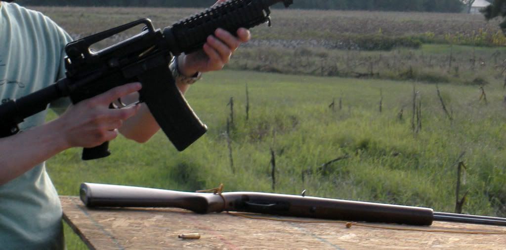

I didn’t intentionally take any pics of the FTEs but a few were caught on camera, and I have included them below.

Were you shooting in that first picture? Your mag looks like it is touching the bottom, and I've heard that if there is pressure pushing up on the mag, then you may have feeding/extraction issues? Just a thought...:confused:
