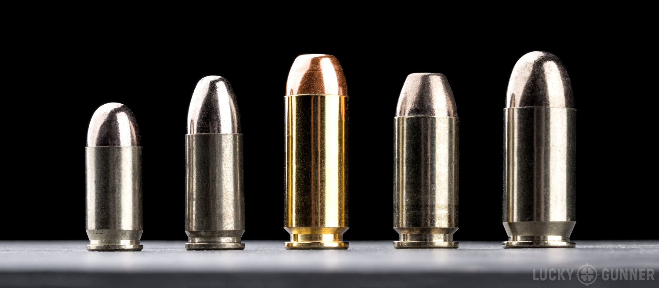

There are plenty of opinions and none of them are wrong. There is a guy on here by the name of Cuda 66 and it is my opinion that he knows what he is talking about when it comes to ballistics. He did not answer so here I go…
Id like to start out with a baseline. The original Jeff Cooper load was 170gr, Fmj, 1300 fps, 600+ foot pounds of energy (fpe) at the muzzle. It has a substantial amount of recoil, barrel rise, kick and this coming from a 4.5” barrel. The goal was to be accurate at 50 yards.
Once you leave that baseline, the felt recoil changes dramatically.
This is my opinion about a few 10mm rounds, what I’ve felt shooting them and what I’ve settled on to carry in the gun.
Musical instrument Font Bullet Gas Motor vehicle
The 200 gr is a heavy bullet with good charge. I consider it to be full power. It kicks hard and flys flat. I don’t enjoy shooting it but I like loading up a mag and watching other people shoot a round and then hand the gun back.
The 180 gr Hard cast has a similar charge as the 200 gr but because the bullet is lighter, it travels faster as it exits the barrel and has more energy, therefore, more kick, barrel rise, felt recoil. That ammo is made for penetration and breaking bones, not deforming, not slowing down, going straight through until its force is met by an opposing force equal to it. This is your bear defense load, your charging moose load, bad guy behind the dumpster load.
The 155 grain has a reduced weight bullet and charge to keep recoil manageable, get back on target, and keep that round moving at a respectable speed and stay flat for a respectable distance. This ammo is loaded to mimic my carry ammo.
This ammo has a penetration distance of 12-14” depending on clothing, mushrooms excellently in 15% gel, all at 15 yards. This is my carry ammo. Ballistics will change from a 4.5” to 3.8” barrel and so will felt recoil.
My advice is to find a 200gr round that moves at 950-1000 fps with 425-525 fpe at the muzzle. After that, try a 170/180 gr round that moves at 950-1000 fps. I think one of those is going to be the sweet spot for that 3.8”. Enjoy!
