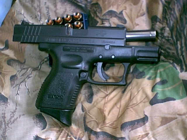

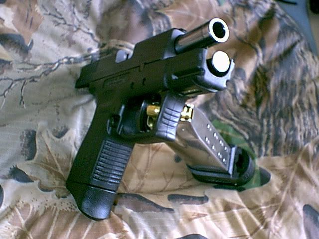

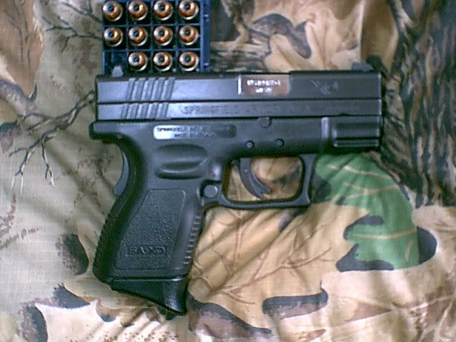

Found a speck of rust on my barrel, so I went to work. Dremel tool with a Dremel polishing pad and No. 421 polishing compound. It now has a mirror finish. Be careful. It gets HOT when you are working on it. I had to stop several times and put it in the freezer for a few minutes. I was a lot more comfortable doing it this way over using sand paper. This method should only result in microscopic changes in the dimensions of the piece being worked. I might take on the controls next. I know someone is going to flame me for taking the 'Protective Finish' off of the parts. Hell, all you have to do is breathe on it and it rusts anyway. I have to oil it daily to keep the rust off, so it might as well be looking sharp when it is done.

I did it between 'honey-doos' and probably had about two hours total in the job. The biggest time consumer was stopping every fifteen minutes or so and putting the barrel in the freezer for about fifteen minutes. It was worth it though, it looks much better in person than my low resolution camera shows.

It doesn't get hot enough to effect the molecular structure of the metal. It just gets too hot to hold onto. That was the guage I used to keep from getting it too hot. (Not using a tool or rags to hold onto the barell as I worked on it.) Didn't freeze it either. Just let it cool to where you could handle it again. I think we're completely safe. Ajames looked at the work and if there was a problem with affecting the metal, I'm sure he would have piped in.
