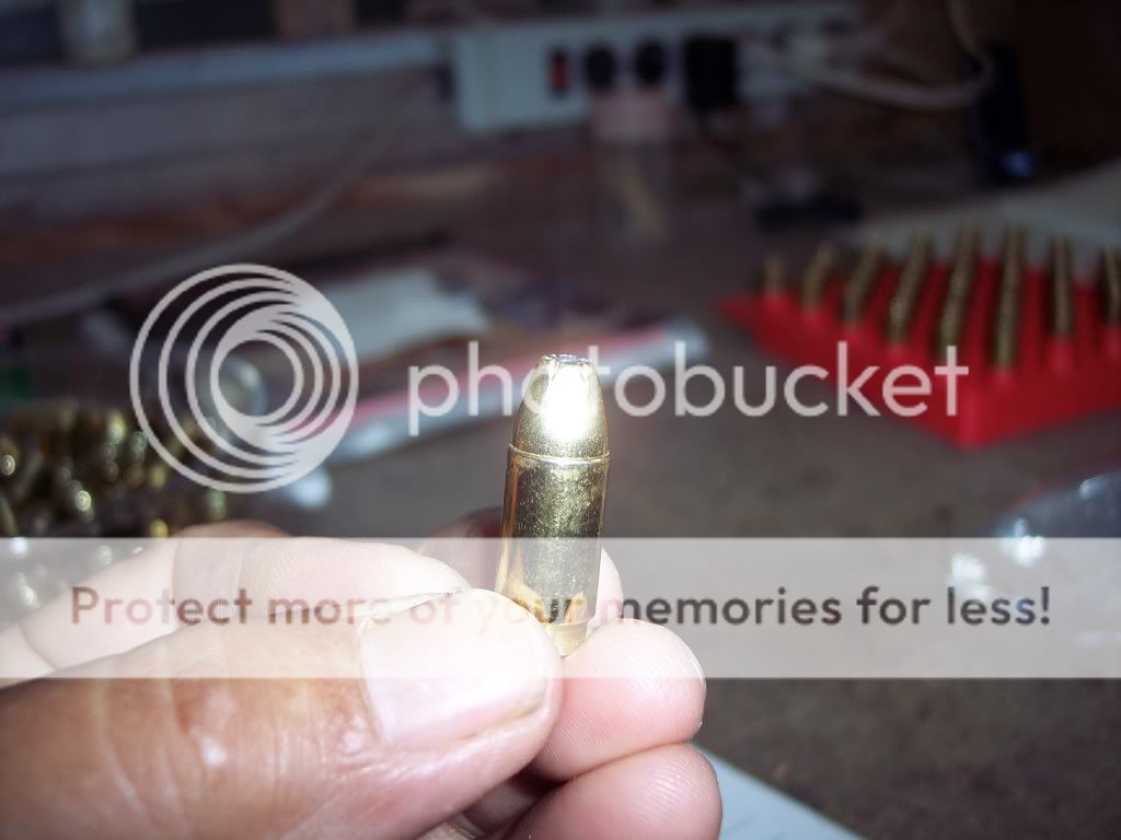

I put a slight roll crimp on my 9mm reloads and they work fine. A couple of the guys at USPSA shoot last weekend said that I should back off some on the Hornady die seating die to get a more tapered crimp. I'm thinking if it works, leave it. What do you folks think?

Roll crimping auto-pistol rounds is ILL ADVISED; they typically headspace on the case mouth.
Taper crimping is something that can be done and if done, done lightly; just enough to hold the bullet in place as it rides up the feed ramp and into the chamber---0.001 to 0.003 less than the nominal case mouth dimension is typical.

Over crimping can result in excessive pressures.

I backed off the crimp on the die. Does anyone use the Hornady Taper crimp die? My COL is 1.075 w/5.8gr Power Pistol using 115gr MG JHPs. I had good results at last weekend's matches. The reloads shot much better than the S&Bs I've been using.

Unless the roll crimp is severe & you are using an uberfast powder, like Clays, running max. you'll have a hard time increasing pressures much by crimping. The crimp shown is pretty mild for a roll crimp, if it's working fine for you, leave it alone.

You should never roll crimp, unless there's a cannelure into which to roll the crimp. Get a taper crimp die for that 9mm!

Try the Lee Factory Crimp die. It resizes and taper crimps the cartridge back to original specifications. I use these for all rimless cartridges and they work great and are very reasonable priced..

Since I have the Hornady setup, I have the Taper crimp on order from Midway. I'm happy with the LNL. I haven't chronoed the adjusted crimp loads yet but I was getting an avg of 1210 fps with the first batch using Power Pistol @ 5.8 gr. I hope I'm not making a mistake by messing with a setup that works, as I went through about 200 rnds at our last IDPA and USPSA matches without a glitch.
