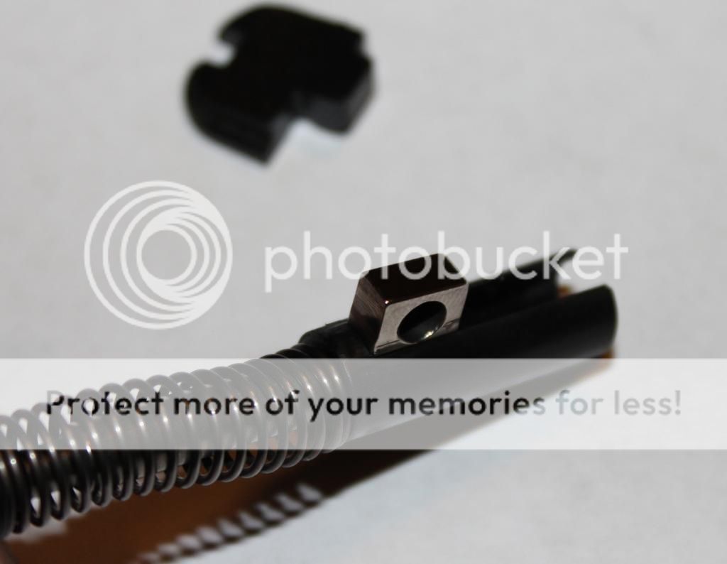

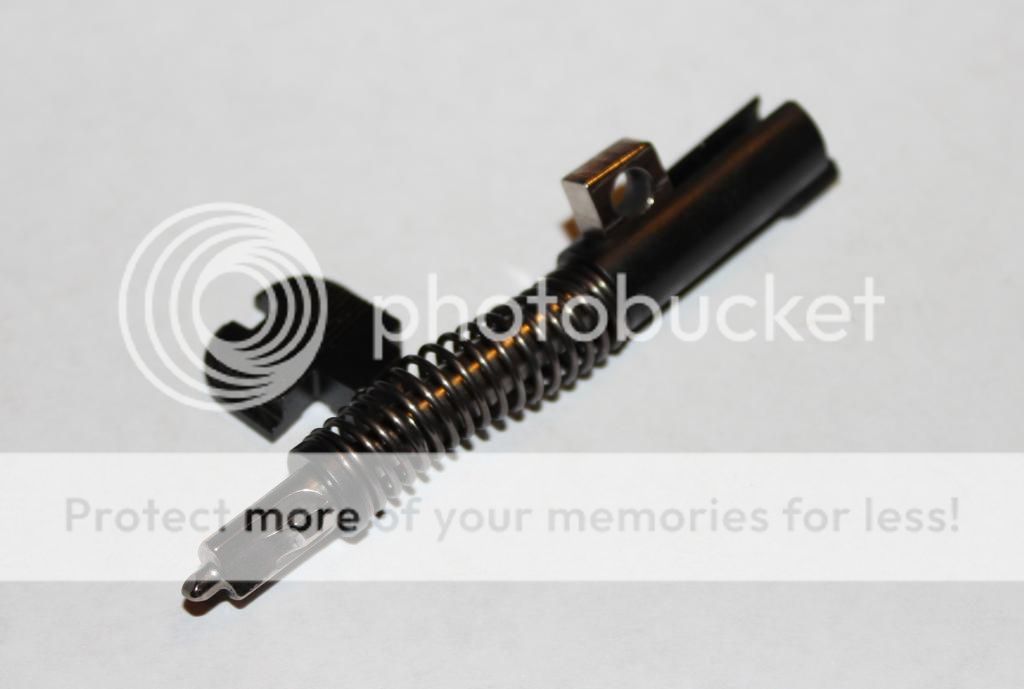

Striker removed...Factory spring on top, PRP Striker spring on bottom.
PRP Striker spring installed.

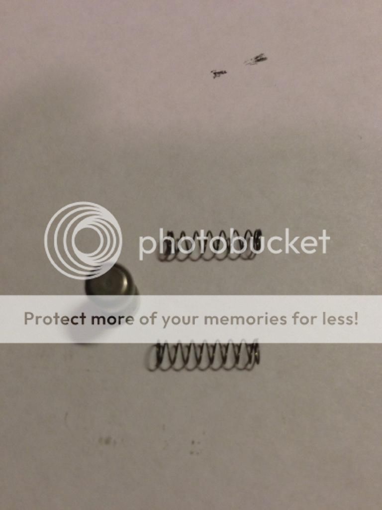

Striker safety spring. Factory spring on top. PRP spring on bottom.
