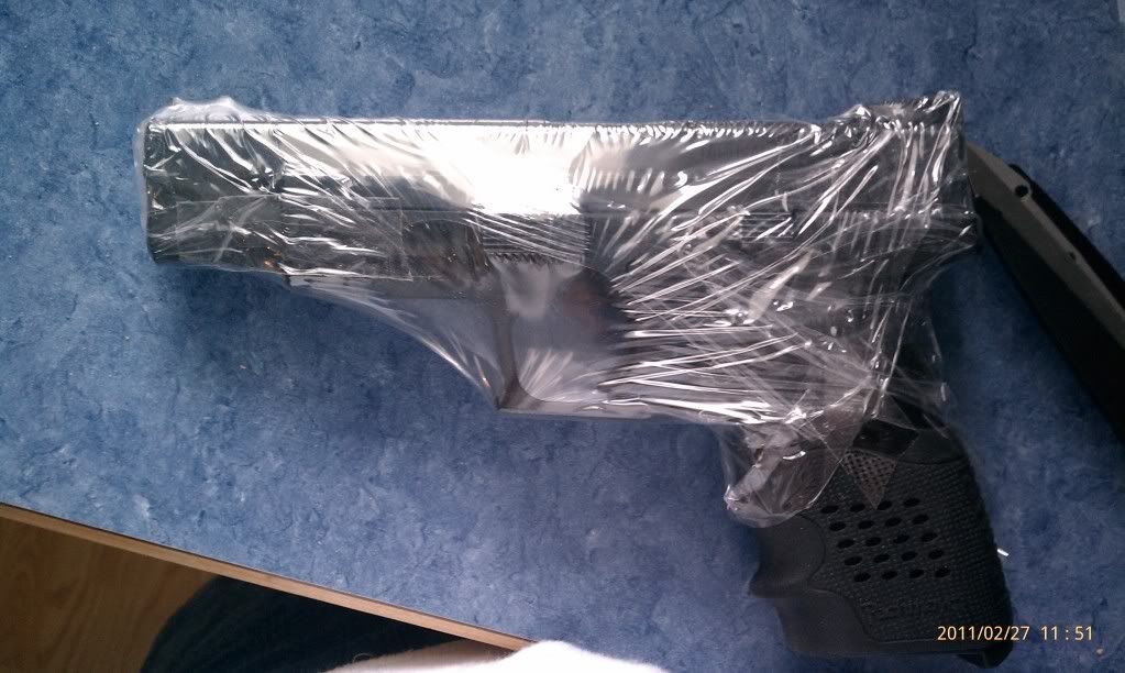

First... to make a form. What better than the gun? I wrapped it with window insulating plastic and took my gfs blow dryer to it [IMG][/IMG]

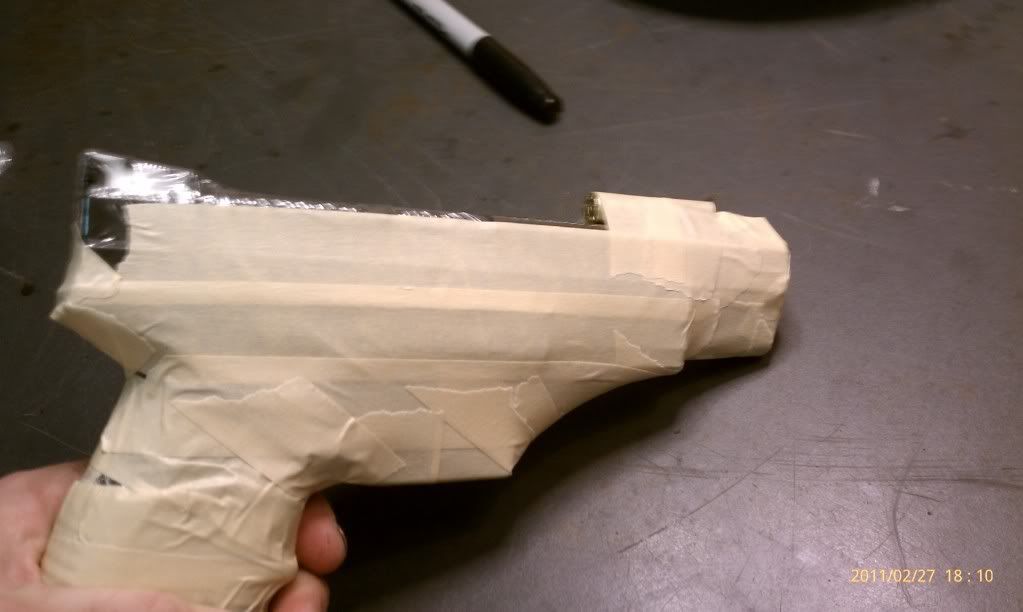

Then i took masking tape to the whole thing to be able to bondo it. To form the top of the holster with a channel for the sight i taped empty 9mm cases between the sights down the top of the slide[IMG][/IMG]

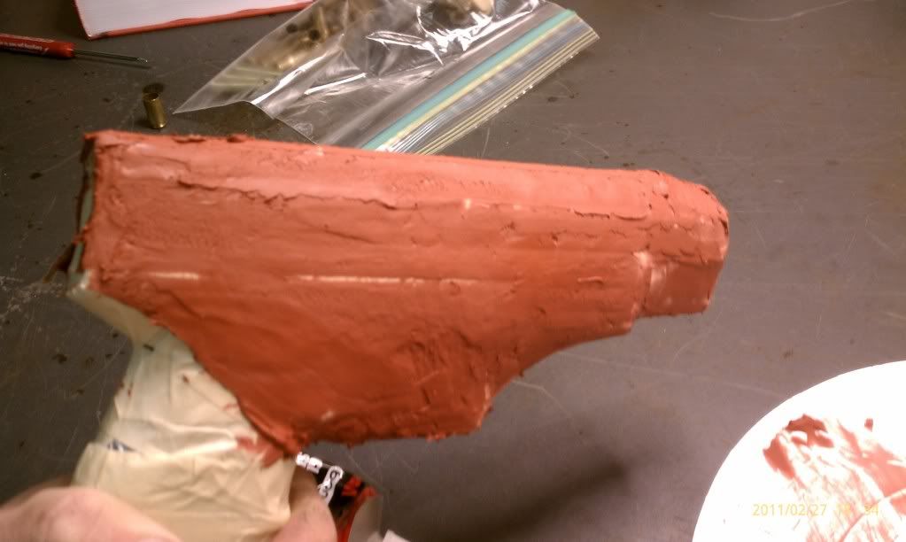

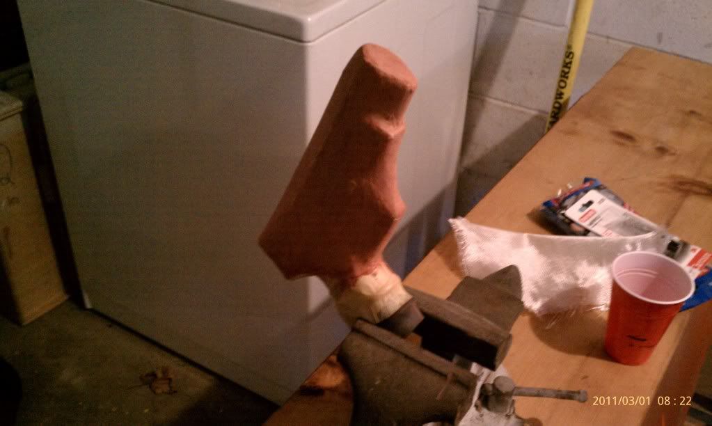

the next step was to make it taper. being that it needs to slide in and out easily the inside of the holster needs to start narrow and get biggest at the mouth. to get that effect with the takedown lever and slide release my solution was to bondo the whole thing and sand it smooth. [IMG][/IMG][IMG][/IMG]
