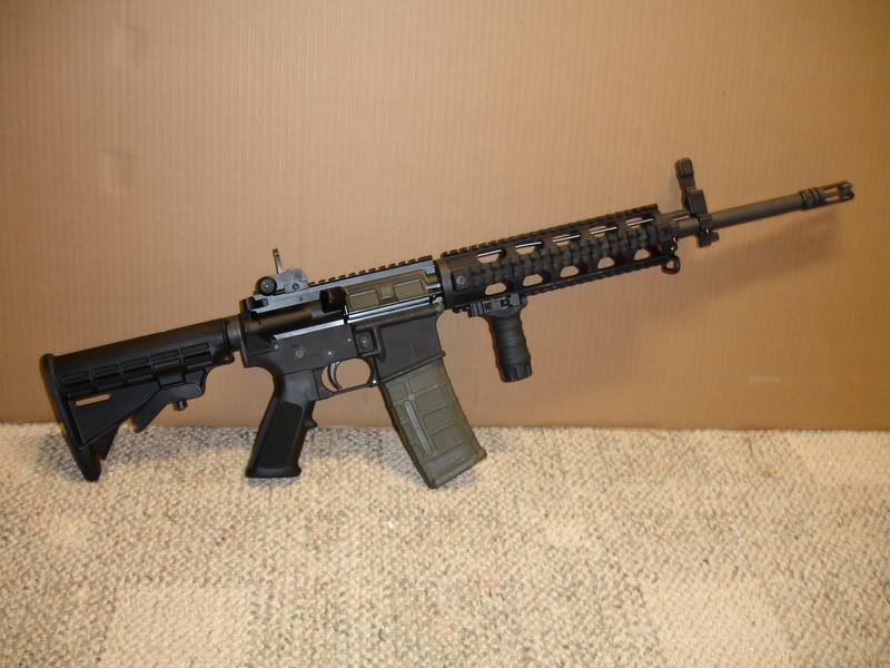

Here is one of my Del-Ton uppers on a lower I built. I think I have about $960 in this rifle as pictured:
Del-Ton complete upper, 1:9, chrome lined, M4 ramps, YHM Lightweight HG, YHM 5C2 hider/comp, YHM flip sight gas block, standard BCG, standard charging handle with Badger Tac Latch.

I should mention I have the Full MIAD grip in FDE. I really love it...but... the rear portion of the grip kept sliding off and I had to epoxy it on. So my last 2 builds I put the MOE grip on, same feel, less money. I do like the Magpul trigger guard on the full grip, but I will just buy the guard separately.
Here is my DTI upper:
4150 steel
M4 feedramps
Phantom Mid-Evil break
