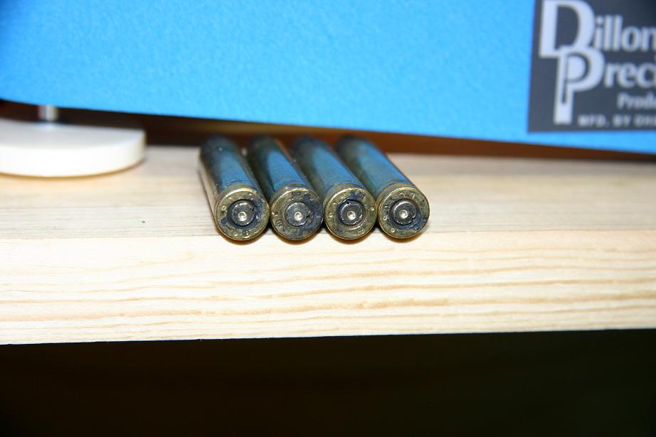

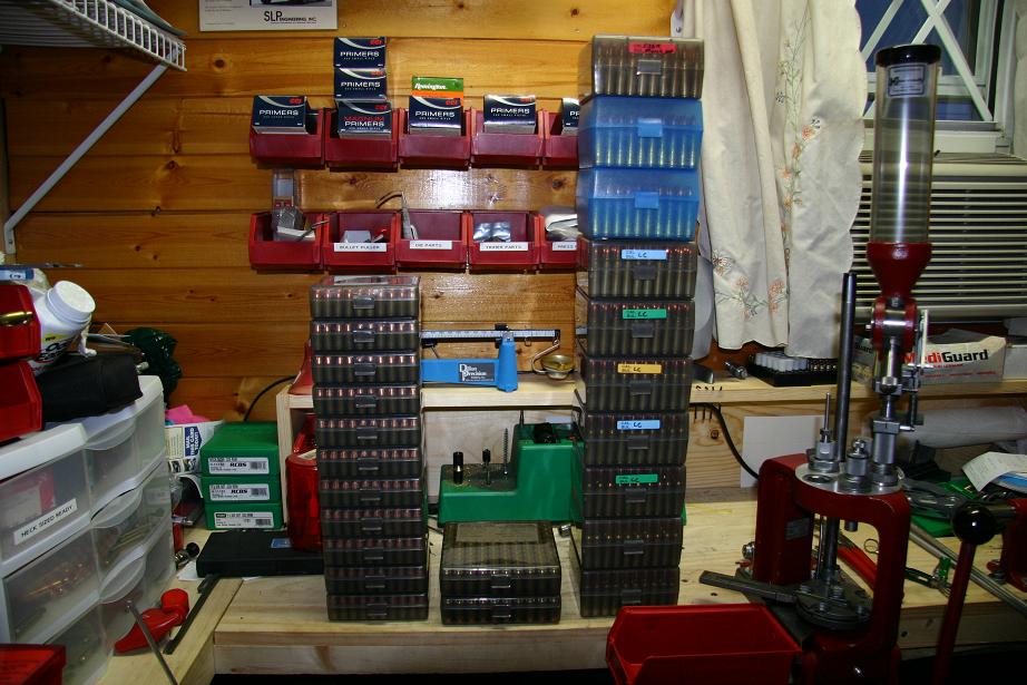

I got bored late last night circa 4am & decided I'd pass the time by taking a few pics. It's not much to you experienced shooters/loaders, but it's new to me so I'm proud of my tiny milestone.
My reloading setup stuffed in a tiny closet of my office:
First batch of .223 (24gr, as per original post)
Cool little .223 closeup:
This is why you don't mess with the Zohan! (First Small Batch of .45acp):
The clockstopper (2nd Batch .223 - 24.5-25gr/100rds)

Looks like a great little setup! I can't wait until I move out of this apt into a bigger one (next may), then I get space to have a setup of my own!

Haha, wish my loading bench was half as clean as that... unfortunately, its tucked away in the corner of my woodshop, which is less than pleasing to the eye inside as it is...
