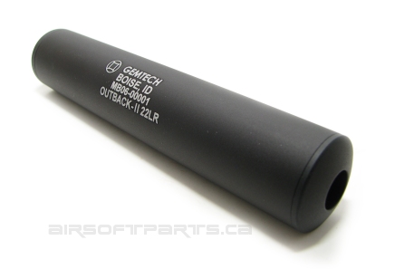

the muzzle break?
Not a suppressor..
suppressor..
